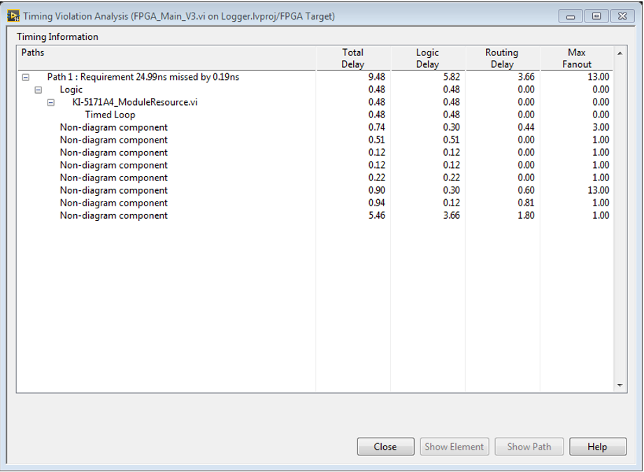

I'm building up a hybrid cRIO build, with the FPGA for a view non-NI modules, and other high speed data capture. One of those modules is a Kistler 5171 A4. Currently, I have no code in the fpga vi relating to the Kistler module. When I'm compiling I'm getting a Timing Violation Error, with a load of non-diagram components, that relates to model.
I don't really have a clue where to go for debugging this as an issue, as without being able to see anything on the VI, I can't understand what might be causing the problem. Can you think of anything I should be considering / looking at?

You'll have to look in the manual to be sure, but I think those vi's can't be used in single cycled timed loop.

Hi Wiebe,
Thanks for the reply. Yes that is what I imagine too, but what's weird is that VI isn't being used on the FPGA vi, and nor do I have a SCTL (attached is the FPGA.vi). Unfortunately, there isn't that much material provided with the module. I'll have a dig around and see what I can find.

Can you double-click those tree items? IIRC they should highlight the offending node.

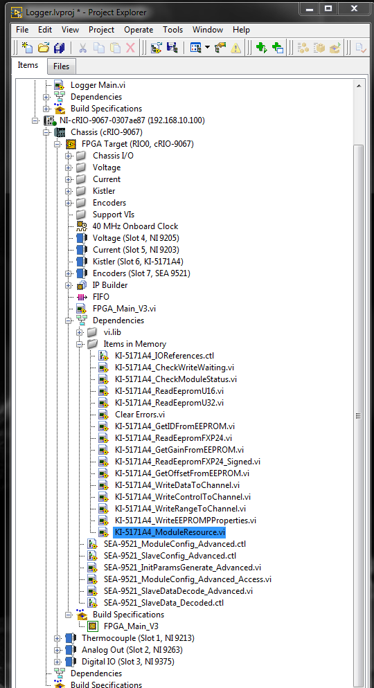

Turns out they are in my project (I assume these must get automatically added when the module is found in the cRIO):
Unfortunately, the VI is password protected, so I'm going to have to contact Kistler.
