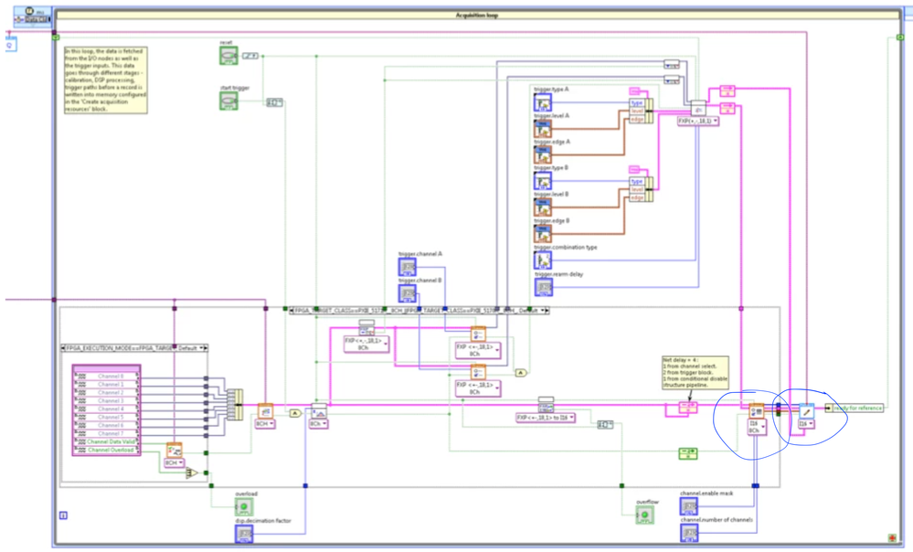

So, in this https://www.ni.com/en/shop/electronic-test-instrumentation/add-ons-for-electronic-test-and-instrumen... link on Figure 4.

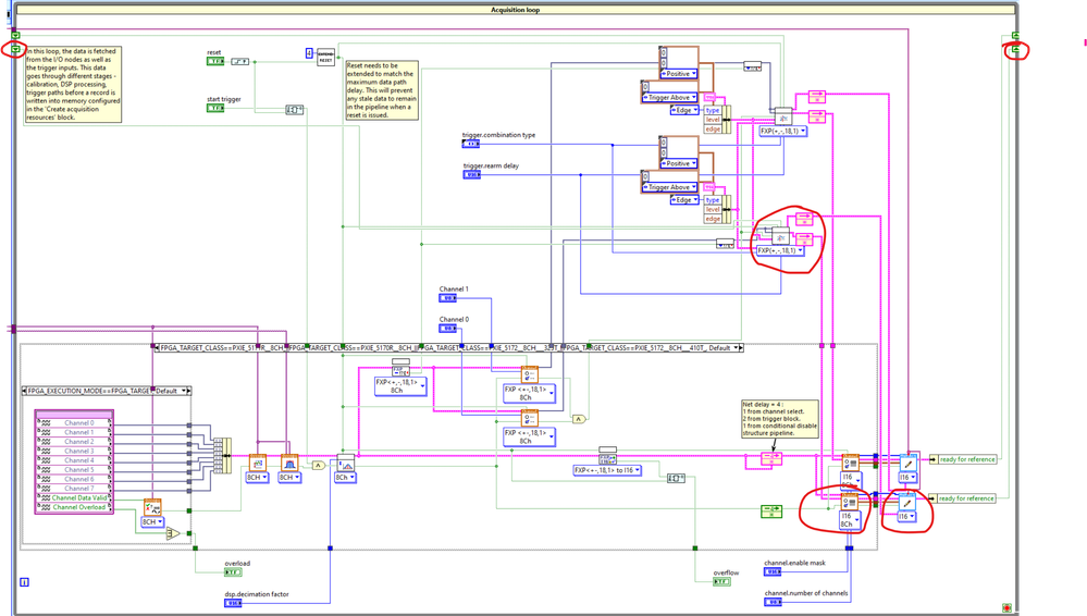

These two VIs - 1. Select and Interleave and 2. Write VI can be used for at least two channels or just one channel if I treat it as one channel to get the trigger level for A and B (Or trigger).
My question is, how can I add multiple Or triggers for four channels and pass it to the 1. Select and Interleave and 2. Write VI with trigger status and timestamps? Right now I see two wires that goes to the feedback node to the 1. Select and Interleave and 2. Write VI.
Do I need to combine four Trigger.vi and see which one got trigger and pass to the Select and Interleave and Write VI?

I think I do understand what is going on. The figure below shows what I am trying to do (This will not work, I know). There is an option that I can see which it is to only pass whichever channel got trigger but what if one gets trigger just after one got trigger? I lose data there.

@Arbores wrote:
Hello @Terry_ALE,
Multiple channels Interleave and Write.viMultiple channels Interleave and Write.vi
Thanks!
When you make a copy of the Multi-Record Acquisition (function circled to the right), it needs its own reference and code outside of the loop that 'instantiate' it.
In the code at the top of the diagram, you will need one set of trigger logic for each channel.  Four copies.

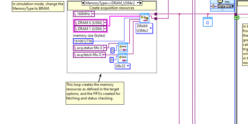

The current FPGA VI has a loop that you are showing.  To the left of this loop is the following code:
It has functions such as the Create Resources.vi which setup the Multi-Record Acq for use in the loop.
If you make more than one Multi-Record Acq (as in your screenshot) you need another one of these.
