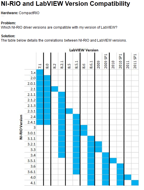

Cool. I think the table below will shine some light on what has been happening. Smiley Happy
Alex Thomas, University of Manchester School of EEE LabVIEW Ambassador (CLAD)
(4,753 Views)
Thanks, unfortunately I have LabVIEW 2011 SP1 and RIO 4.1; which should be compatible.  Once again I appreciate the help.  I really don't know what else to check on.
