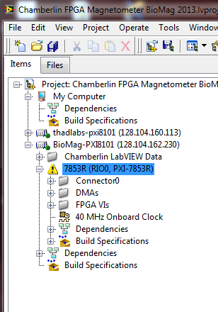

Now, when I open up my project in LabVIEW 2013 Project Explorer, my FPGA shows up with a yellow warning triangle next to it (see attached picture). The warning message says:
"Software support for this FPGA target is not installed on the computer. You can view and copy some of the items in the project, but you cannot compile any VIs under this FPGA target until you install the target support. Refer to the specific hardware documentation for information about the appropriate drivers and for information about installing and configuring the FPGA target."

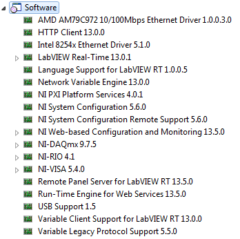

As far as installed software, I have LabVIEW 2013 SP1, LabVIEW 2013 FPGA Module SP1, LabVIEW 2013 Real Time Module SP1, as well as Xilinx Compilation Tools 14.4. On the TARGET chassis (with the PXI-8101 controller), I have attached a list of the installed software.

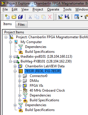

Here is an image of the same project opened in LabVIEW 2011.
