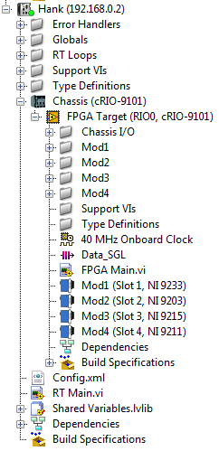

I'm trying to implement the LabVIEW FPGA Waveform Acquisition and Logging on cRIO template in LV2012sp1 onto a  cRIO-9002.
  • I've followed the Project Documentation guidelines for "Adapting This Sample Project To Your Hardware", and then I compiled and ran the "FPGA Main.vi" without errors.
  • As described in "Running this Sample Project", I've edited the "Configuration File Generator.vi" and I've generated the Config.xml file and placed it in the project as shown.
  • When I try to run the "RT Main.vi" as described in Running this Sample Project, an error is produced: Shared Variables deployment failed (error: 1967357949... Unable to query MAX for Shared Variable Engine. Make sure the Shared Variable Engine exists on the RT target..."  As I review the related forum posts,  most problems seem to be related to version mismatches and such.  Looking at my software install in MAX, it appears that I have the necessary shared variable engine components are are being suggested as potentially problematic.
So I'm stumped as to how to proceed and the documentation guidelines do not address this issue at all.  I would greatly appreciate if someone could point me in the right direction.
