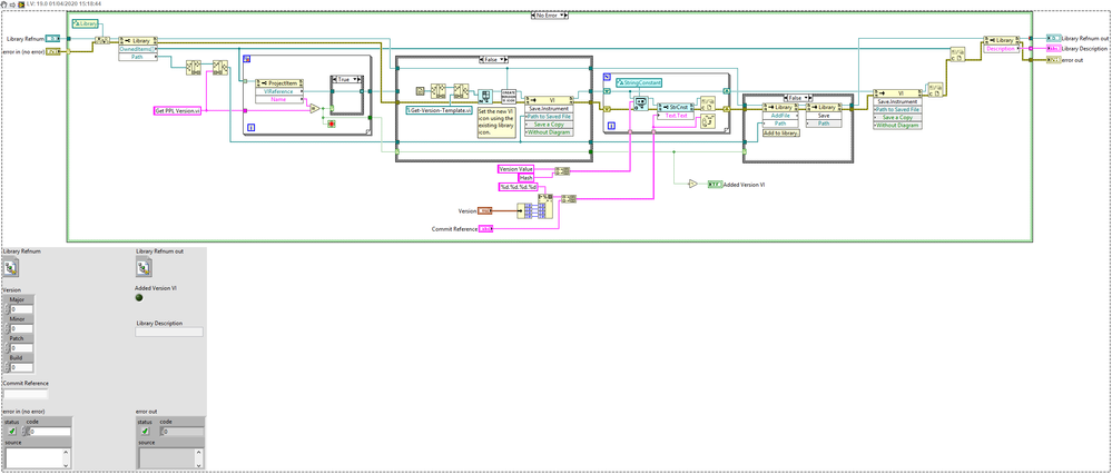

Maybe a quick question: how are you building the bitfile? You've mentioned a Linux computer a couple of times and passing off a C API(?) but I'm not sure I've understood correctly.
When you say someone should be able to find the version from the .lvbitx file, does that imply whilst it is running (i.e., I run the FPGA VI on an FPGA, and want to check a front panel indicator telling me the version) or you want to grep some value from the file on (host computer) disk?

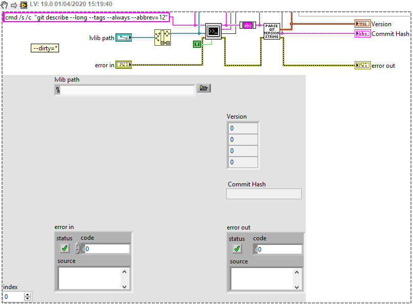

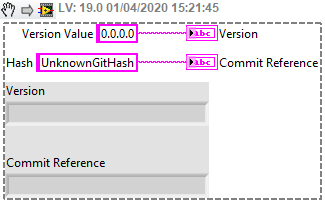

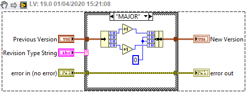

What I'm doing for my PPL builds is basically this (which covers the first but not the second option above):
Script a Version VI and add to library (you wouldn't add to library probably)Script a Version VI and add to library (you wouldn't add to library probably)
Get current version from git tagsGet current version from git tags
Set new version based on old version and "Build Type"Set new version based on old version and "Build Type"Template for the VI to get versionTemplate for the VI to get version
Parse the version string from git to a Version clusterParse the version string from git to a Version cluster
and should work for FPGA too (substituting the string containing the version hash for probably the actual number given as a hex string here, since no strings on FPGA).
You'd want to avoid the creating a new VI and instead modify an existing VI, since you'd need the FPGA VI to call that VI in your actual source code (so no need for the Adding to Library stuff).
This is scripted during my build process, so for you this could be done automatically after checking out the source, before calling the Vivado/ISE compiler, but perhaps you're doing something completely different...
It avoids any manual interaction with version numbering (beyond specifying the "Build Type" via commit message) and ensures all the PPLs are build with automatically increasing version numbers.
