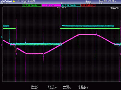

Im trying to detect the zero-crossings on a fairly noisy back-emf signal on a brushless dc motor, the signal is more less the purple signal below, with six commutation spikes per period.
Back-emf signal
Unfortunately, the zero-crossing detection block in LabView FPGA also detects the commutation  spikes. I would like to filter the signal (for example with a moving average) to get rid of te spikes or make them smaller. I tried to implement the built-in Butterworth Filter (cut-off 5, 10, 20kHz, samplefreq 200kHz), but this did nothing, my program still detects false zero-crossings.
How can I filter these false zero crossings out? Note that this is for a high speed application, with fundamental frequency of 20 to 30 kHz, so the filtering should be sufficiently fast.

Are you using an appropriate hysteresis level to avoid repeated zero crossing detections? A good filter should be able to reduce your spikes to, say < 20% of you fundamental signal and if you use a hysteresis window of 50% that would prevent false triggering. If your signal amplitude changes over time you could update the hysteresis level continuously (for example by using a 50% level of previous peak value).

A very efficient method would be to use a debounce filter. Effectively only count it as a zero crossing if the last n samples have all crossed zero. It does introduce some lag into the signal though.
The faster response would be the opposite - If I have had a zero crossing in the last n signals don't register a new one. This way you still get the first edge to cross but not the extras.
This will handle multiple triggers at the crossings - with a high frequency cutoff for the spikes might work

Hi Henrik, thank you for your answer.
The zero-crossing needs to be detected almost instantaneously, because at that exact moment the BLDC needs to commutate. Some deviation in time (in order of microseconds or tens of microseconds) is possible, but this decreases the efficiency of the machine.
The sample length is about 40 to 50 microseconds. I might implement the median filter, I have a fairly good idea of how that should be implemented. I'll keep you posted on what I do.
Message 7 of 9
(6,524 Views)
Hi James_McN and LocalDSP,
I'll answer to both of your posts here, since some more explanations from my side are needed.
I have decided not to use filtering, only as a last resort, since it will introduce too much time delay. Even with a simple moving average, it will not be easy to reduce the spikes without introducing significant delay.
However, the spikes are not random noise. They are caused by commutations of other phases of the motor, which I control from within labView FPGA. Each time a commutation happens (right before the spike) I generate occurence that sets a variable that prevents measuring for a fixed time. This prevents my zero crossing algorithm from detecting the spikes.
Now as for detecting the true zero crossings, I think a debounce filter will be excellent. Right now I try to do the opposite as you suggested, but this causes the zero crossing to be very inconsist. A debounce filter might be more stable.
