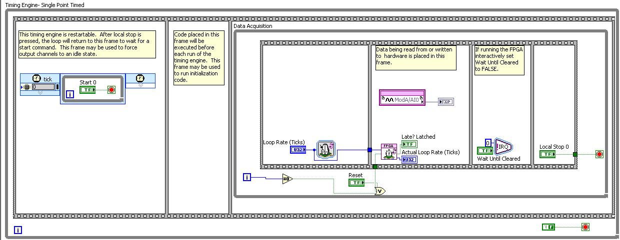

I'm just learning the board, so bare with me... I'm trying to sample an external frequency generator that I control the freq/amplitude, etc. Then I plug that into the sbRIO board under AIO, and GND. Now, I think I want to create a realtime app that will sample, compile and spit out a waveform that looks like what I dialed in on the frequency generator... So I created a realtime project with 2 loops, and file I/O. I then created an FPGA vi through the explorer. I then went to the data point in the FPGA vi, and bound it to the data - network shared variable.. I'm not sure if I'm on the right track here or not.... Here are some screenshots of what I have been working with for further explanation.. Any help is appreciated.

Kyle,
If you want to do waveform acquisition and streaming, you will probably need to sample faster than the IRQ based architecture you've started with will allow.  I would suggest starting with the cRIO Waveform Acquisition reference application developed by the NI Systems Engineering Group to get higher performance.
Most CompactRIO example programs build into LabVIEW are also compatible with Single-Board RIO.  For examples that will work with the onboard I/O of Single-Board RIO, search for 9205, 9263, 9425, or 9476 for the AI, AO, 24V DI, or 24V DO examples, respectively.
