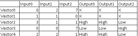

      I have a huge simulation pattern vector text file that I wish to run and output on a FlexRIO, to test a DUT's custom scan chain.
Each line of the txt file is as follows.

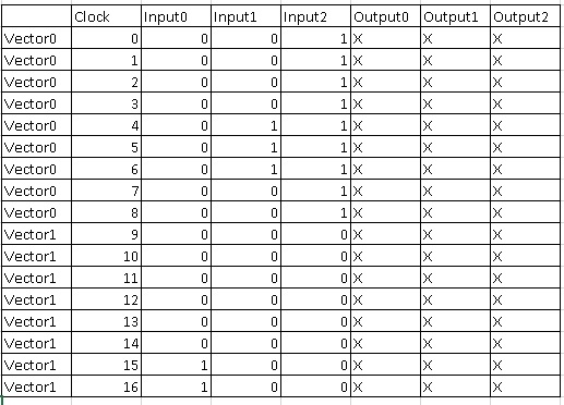

I need to translate this into a waveform where each vector is 9 clocks long (for timing resolution purposes) e.g. 0 = 000000000, 1= 000000011 2 = 000011100, ... 7 = 111111111
So the first 2 vectors would look something like this:
As my file has ~4M vectors and each vector is at least 9 clocks (may in crease to 18 clocks for improved resolution) a file for all the clocks isn't feasible in the host, (Input file is ~200M and output from the FPGA will be the same, also comparing input and output would not be possible.)
