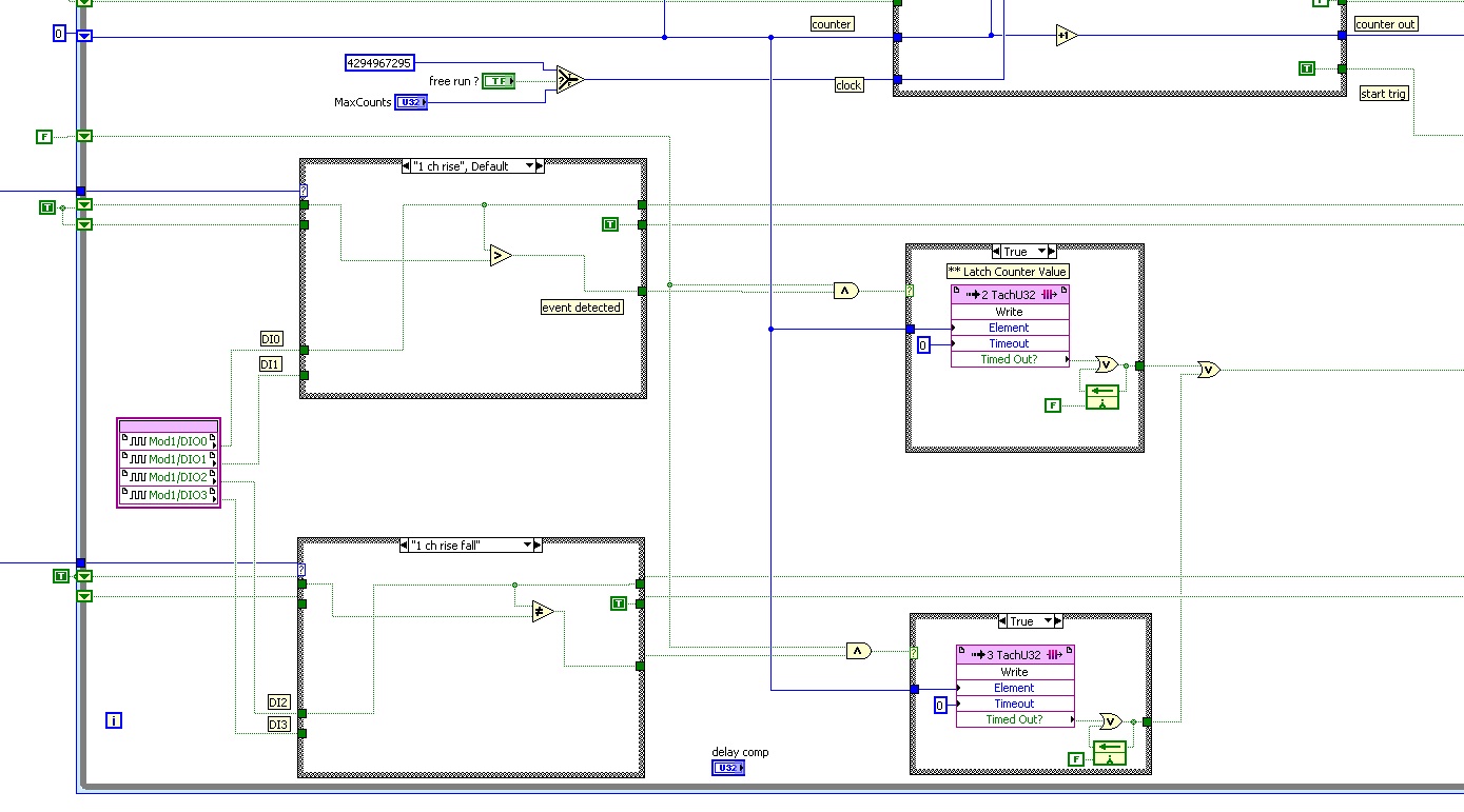

My application focus on measuring time between digital TTL events. The hardware used consist on cRIO9068 and high speed 9402 module.  Since the hardware channel can run up to 16MHz and FPGA single loop can achieve 80MHz clock, I aspected to have for this application an accuracy around 5 ticks (1 ticks = 12.5ns = 1/80MHz, 5 ticks =62.5ns =1/16MHz).
Well i can test the application feeding squares to 9402 via a function generator (high quality one). While the accuracy on time regarding only rise  (or only  falling) TTL  events is quite good (10 ticks at 1kHz ) once i use to deal with both rise and fall events the accuracy became around 60 ticks.
Who is guilty here ?
However from what i see the paper specifications for these hardaware are not meet

I think GerdW meant "Timed While Loop" although I haven't seen that abbreviation before (and I've been using LabVIEW FPGA for a long time).
We really do need to see your code, as well as the project file to see how you configured your top-level clock and any derived clocks, in order to provide any assistance.
I would discourage you from using comparison functions (such as greater than/less than) for comparing booleans. Use standard boolean logic (AND, OR, etc) instead.

maybe i wasnt too detailed but offcourse the code is compiled (correctly) with a single cycle timed loop with a derived (x2) clock of 80Mhz. I tried all the code possibilities regarding rise and fall reckon with no better luck
