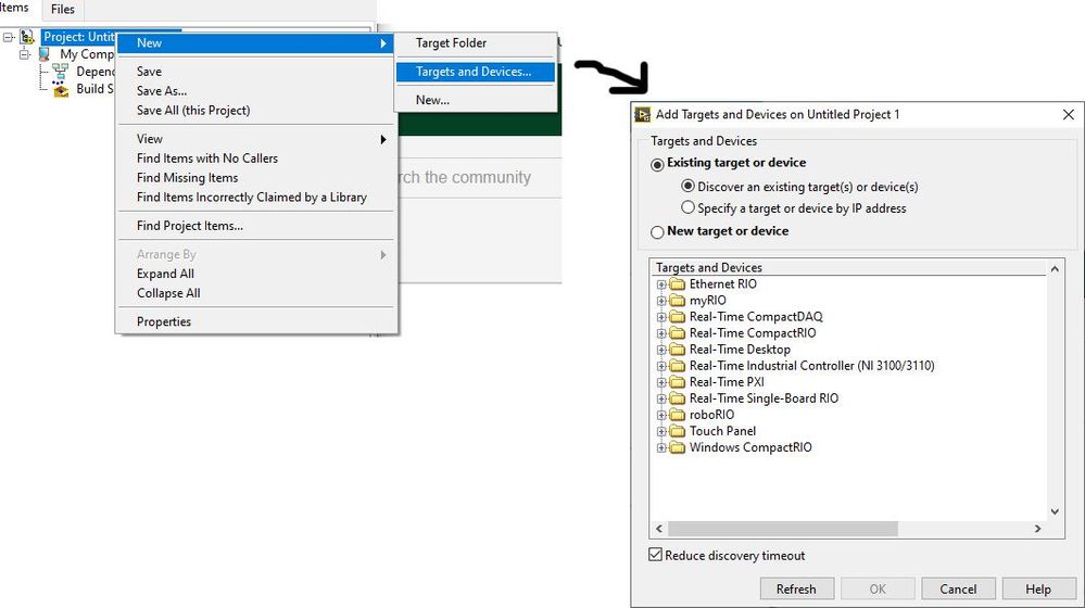

Hi there,
Thank you for getting back to me. Unfortunately no I do not have all of those elements. I have attached a picture of what I currently have.
Am I missing some drivers/ software?
Many Thanks,
Danny
(2,474 Views)
You don't need all these elements. For PXIe-7856 you need RT-PXI. So try to search there.
