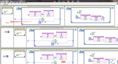

1.The real question is how does the FPGA accurately receive and use the hundreds of thousands of data sent from the upper computer?
2.I use the FIFO transmission of the upper computer, the next computer also uses the FIFO reception, how to ensure the integrity of the data?
Message 3 of 13
(3,391 Views)
ZYOng
God help me look
:Will data loss occur when the fpga receives data from the host in this way?
Message 4 of 13
(3,361 Views)
See How DMA Transfers Work (FPGA Module)
Your code looks good. As long as you are configuring the correct buffer size and using the correct write rate so that fifo overflow or underflow does not occur, there will be no data loss.
You can use the Timeout? output to monitor if fifo overflow or underflow happens.

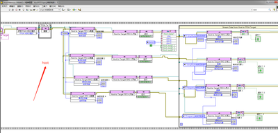

Memory DRAM  ,  I use PCIe 7821R hardware.
  • Can this memory read data at intervals?
  • I actually tested it, and the interval read was unstable.
    • Is it because Memory can't read at intervals?
Message 8 of 13
(3,291 Views)
Hi jamse,
Which "intervals" are you talking about?
Keep in mind:
  • Many of us cannot read Chinese text, so you better provide an English translation or comments in your block diagram.
  • When you want to attach screenshots then you should attach real screenshots, but not images taken using your mobile phone in front of your computer monitor…
  • Most often it is recommended to attach real code instead of images of code…
Message 9 of 13
(3,257 Views)
Thank you for your kind reminder
I mean that my Memory DRAM reads the data from the first address to the last address one by one, and now I want to read the data from address 1, read the data from address 4 next time, and read the data from address 7 next time, each time with an interval of 3.
I read them sequentially and the output data was normal.
If I read it at intervals, the output gets messy.
