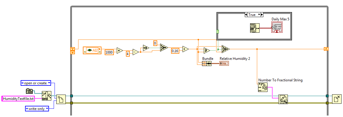

Facing a problem in writing textfile, badly need help.
I am already close to finishing this. Just that the problem i'm facing is that i can't seem to log the data into the textfile.
It says that the concatenate has an error or something. That's the problem because i can't seem to find it.
Do i have to use "Format string" to convert the numbers to string first? Because i've tried it before, it can't work too.
Please help. Thank you in advance.

Where is the concatenate function you say is causing an error?
Yes, you need to convert the number to a string to be able to write to a text file.  (I don't understand the number to boolean, to 0:1 dance you are doing in there.  What was the point of that?)
If you have a problem with converting a number to a string like you said, then post a VI that show that attempt.

why are you using 2 loops? you can write to file in the same loop....

I want to write the datas into 2 separate files.
that's fine, though you do not need 2 loops to do so....and it looks like you have data flow dependent loops

@apok can i know what do u use fr the one beside "open/create/replace file?"

You can use write to spreadsheet vi. It may be simpler. Just convert your output into 1D array.

I actually want it to be a raw data. Thats y i need to put them in a textfile

What do you mean by raw data.

Can i know what function do u use for the HumidityTextfile.txt? and i want the data to be logged continuously.
I tried editing and it only log 1 data and that's it.
