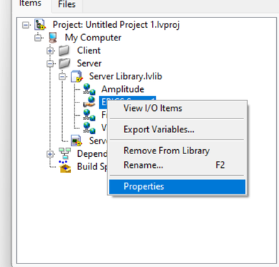

Right click on the server and choose Properties to get the Configure Server Window.
Click Add/Remove Variables to add the variables you added to the library.
Here is the issue. When you add the variables the first time, they are only in the Project option.
Add them anyway, save and try to deploy. You will get an error. Go back to the Configure Server window and now add the variables from the Network tab. THis seems to correct the path names.
Remove the variables added from the Project option. Now try to Deploy/Run your VI.
Worked for me. Seems to be a bug in EPICS.
