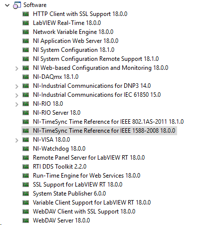

However, I have confirmed that the "NI-TimeSync Time Reference for IEEE 1588-2008 18.0.0" is installed on my cRIO. Is there another piece of software or something else that I'm missing?
From NI MaxFrom NI Max

To monitor Linux RT cRIO's you should use the NI-Sync API. It should already be installed on your system.
In example finder, go to Hardware Input and Output >> Timing & Synchronization >> Time-based
And see examples:
  • Get Time References
  • Monitor and Configure Time References
The NI-TimeSync property node you're using currently is only supported on older Pharlap & VxWorks targets.
(3,498 Views)
Thanks @LindsW. That was able to point me in the right direction. I also had to disable IEEE 802.1AS via the Enable and Disable Time References example, but I'm now able to syncrhonize with my Grandmaster.
