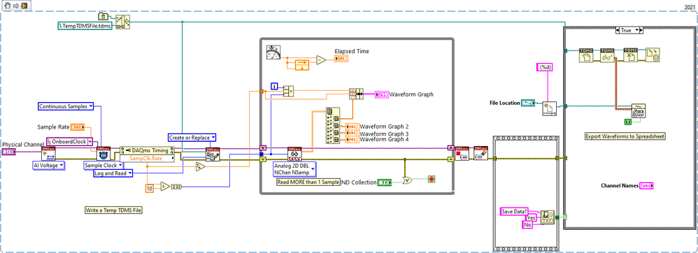

Below is a quick mod to get elapsed time on the plot. I only did it for ONE plot, you need to change the properties in the other plots for relative time on the X-Axis. See if you can figure it out.
