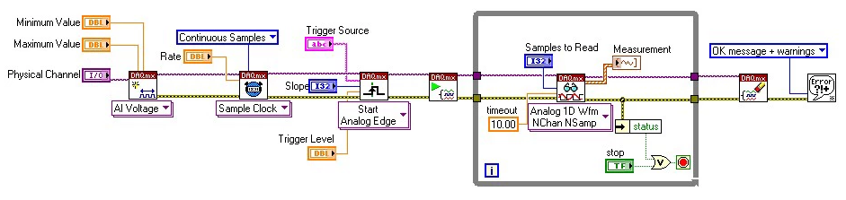

I just found on this THREAD a VERY interesting NI article
Non X Series with no available counters: If you are not using an NI 63xx Multifunction I/O (X Series) DAQ board, analog input is not inherently retriggerable. However; you can retrigger a board by starting and stopping the DAQmx task each time a trigger is received. This will reconfigure the settings on the card and therefore re-arms the analog hardware trigger. This method, however, introduces significant hardware delays and...
but since it seems I have an X series, This might be the key to what I'm looking for

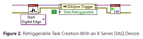

Just for information in case someone else is looking for this. The DAQmx Trigger node with the property "Start.Retriggerable" works perfectly.
So node inside the first loop, and Stop task outside the loop. This only works if your hardware has this capability... for more info read the article I linked in the solution.
