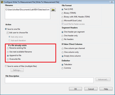

You could try having the second Write to Measurement File VI write to the same file as the first VI, but change the setting under "If a file already exists to Append to file".

Doesn't look like that will work....

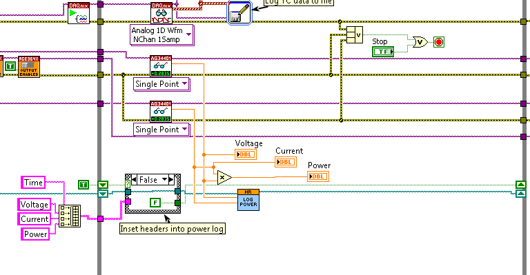

Please show your code and explain better what you want to accomplish. Do you want all of the results on separate columns? Is the dmm code in a separate loop?
Message 4 of 21
(5,023 Views)
Here is the area of my code that includes logging of TC(Thermocouple) data and logging of voltage, current, and power. The TC data is fed to the Write to Measurement File VI while V, C, and P are fed to a subVI which continuously logs them in a seperate spreadsheet file. Ultimately, if possible, I would like to be able to just feed the V, C, and P values in with the TC data where they would be logged in their own colum along with the TC data.

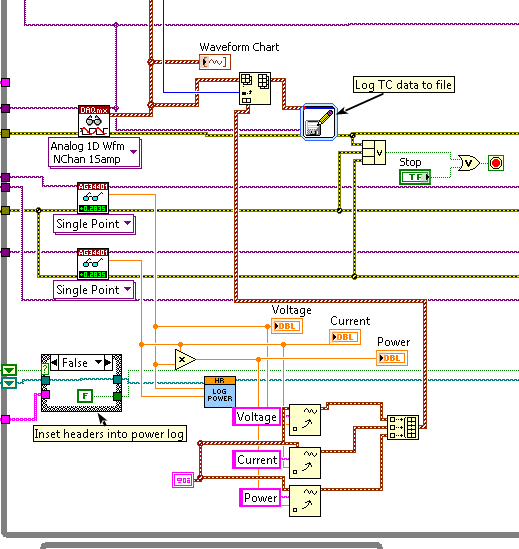

How did you do this attempt? Show what you did, please. I'm posting from my phone so an image would be appreciated. I would expect a simple conversion with the Set Waveform Components.
Message 8 of 21
(4,985 Views)
I haven't worked with waveform datatypes before so excuse my ignorance :). Here is a failed attempt (sorry for the ugly wiring):

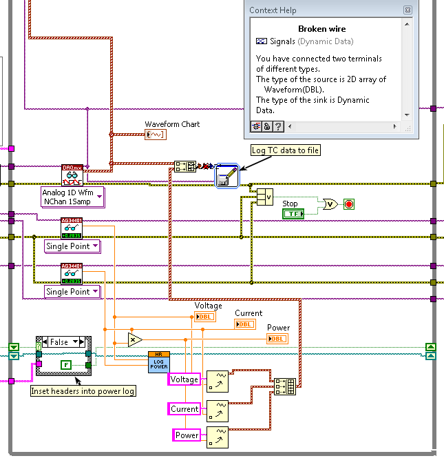

Just tried this(below) and the tdms file had a new sheet for each temp measurement and I don't see any of the DMM inserted into the file.
