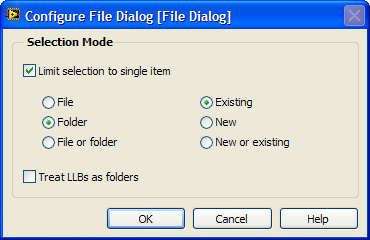

  5. Configure the express VI to select a folder and an existing item, leave the selection enabled to limit to a single item.
