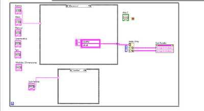

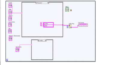

Good morning community, I tell you about my problem, I find myself programming a menu where when selecting a data from my
ComboBox -Family
My second ComboBox starts, where different data will appear depending on what I have selected in my first ComboBox, which is going well so far.
The detail:
The Array as you can see I have 2 data and only one of them (The first one) appears in my second ComboBox.

It's not clear what you want.
  1. Why do you have a greedy loop?
  2. Why do you use 2D arrays of string/value cluster pairs if each 2D array only contains a single element?
  3. It makes no sense to index out two elements from an array with only one element.
  4. so you are writing the String/value property twice in a row, the second time with the default element, which is empty strings. You'll never see anything useful!
  5. Your code really makes no sense at all, so I don't quite understand what you want.

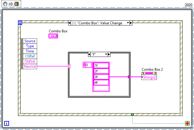

I think you're after something like this:
/Y
