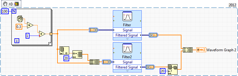

Short answer, not easy to do it without a bit of a bodge. However, following the advice in the last para of this page

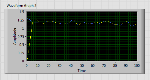

True that the Express vii may not be the best choice, but using the init/cont terminal of a standard filter vi will not solve the OP's problem.
As I understand it, he is specifically trying to eliminate the rise from zero at the start of the first data set (though says he is unsure of the behaviour on subsequent data sets too). With no prior data, a filter vi will ramp up from zero regardless of the setting of the init/cont input.
There are two ways of handling this problem. The first simple yet inelegant way is to supply some prior data to the filter to get the output up to level before your real data starts. The second is to use an advanced FIR or IIR filter and supply initial conditions to the coefficients array (see FIR Filter with I.C. VI ) - however this is supplying the values of the coefficients (not the data) and working them out is depressingly complex (rubbing sand in one's eyes is probably less painful).
However, for subsequent data sets (running the loop again after it has been run once, as the op puts it), the init/cont input is the exact right solution 🙂
