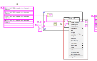

I have the following problem:
I have a cluster that comes from another system and it returns to me this way in some cases, with repeated values.
I need to filter this cluster so that only one item of each Value appears, from the oldest to the most recent.
Could you help me?

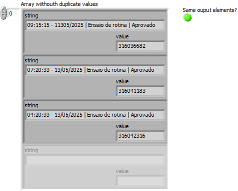

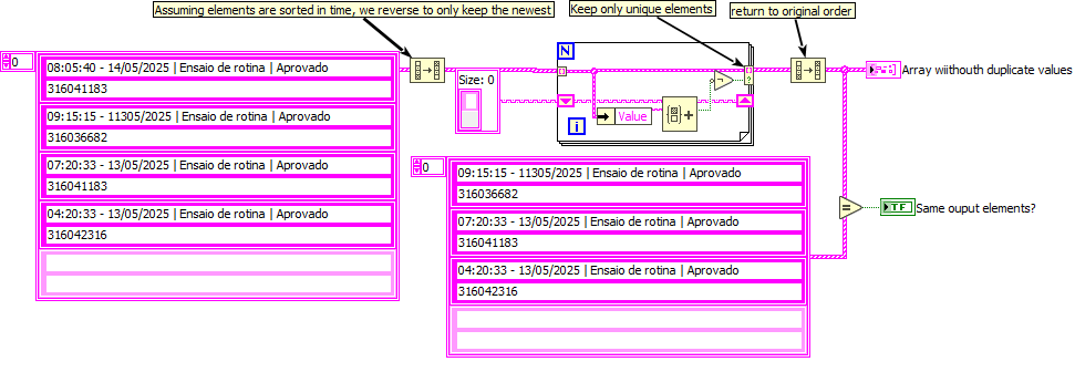

Hello Leandro,
If I understand your need correctly, you had a good start with your VI.
Here is one solution not far from yours :
(776 Views)

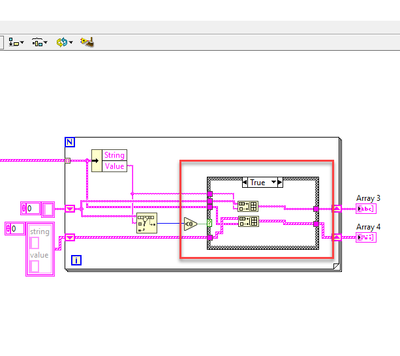

You made some mistakes with the build array.
https://tmesystems.net/
(772 Views)
Oi Leandro
Vc ta indo na direcao certa. No Case true vc so precisa modificar o build array pra aceitar a array do shift-register como concatenate array.
Desta forma, a cada novo elemento, o codigo vai incluir o novo finding no array da iteracao anterior.

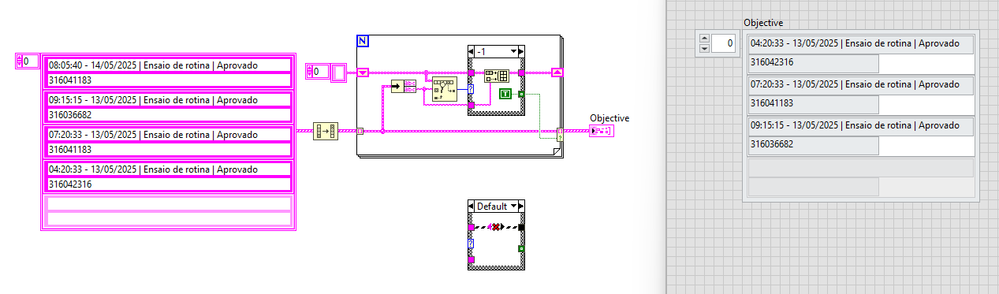

Searching through an ever-growing array can get expensive. Since you have LabVIEW 2019, you can use a SET to keep track of unique elements. For large input arrays this will be orders of magnitude faster.
