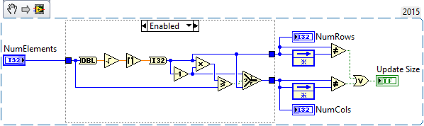

Of course you can also make my solution "all blue" (the orange square root is somewhat a blemish:)). I am sure there are even better, more faster converging integer square roots, just try it. 😄

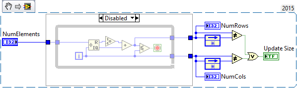

Other than this being "all blue," are there any advantages to this approach:
Over this one:
All I see is that as NumElements increases, the processing time will increase with the while loop while the time of the selection will be relatively constant.
Message 12 of 13
(1,788 Views)
I would go with my q&r solution (the one with the sqrt). Easier to read than using all these compare and select nodes. Performance does not matter here.
