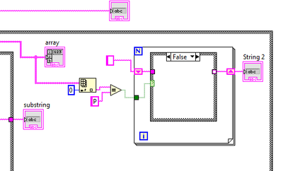

And if I put in a for loop? Because with the first thing I have done I am comparing with the letter "P" only the first string of the array.
I mean something like this
Message 32 of 37
(1,361 Views)
Accepted by topic author labview99
If each array element is just one letter, you shouldn't use the index array.
Simply compare the array with the letter, and you'll get an array of Booleans.

Compare the P to the array.  You'll get an array of booleans.  Do OR Array Elements which will give you a True if one or more of the elements in the Array is a "P".
