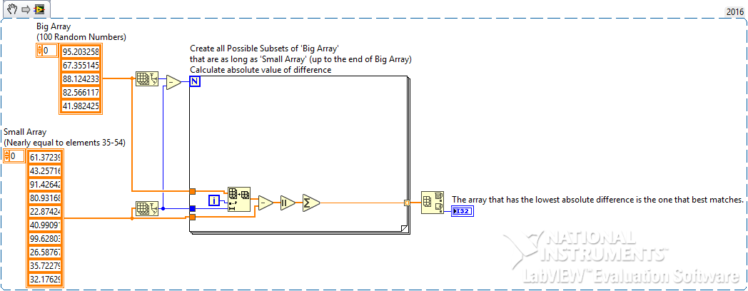

This approach is not "optimal", but it is effective.
This works even when the sub array is not an exact match to a portion of the big array.
This can find a 5,000-element subset of a 100,000-element array in 8 seconds, which is not super-fast, but may be suitable for your needs.

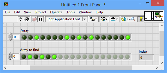

@Valentin87 wrote:
Below I attach picture with example what need to realize
Flatten both to string and search string.

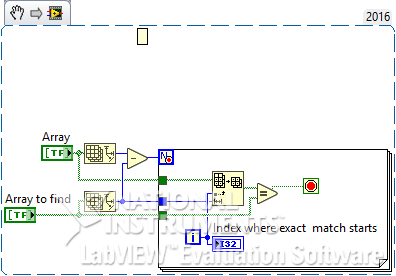

This method will work with Booleans, provided you know that there will be an exact match.Boolean Exact Match.png
If you think the match is likely to be only approximate (ie, 5 out of 6), or might not happen at all, we should take some extra steps to account for that.
