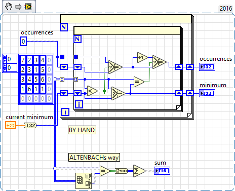

How many times? For example 4 Times min value in Photo.excuse me my english bad

Array min&max will give you the value.. Compare it with equal to the 2D array, convert the resulting 2D boolean array to 0,1, then sum the array elements.
(if the arrays is very large, insert a ToI32 before the sum. For large arrays, you might want to limit all the additional 2D array allocations)
