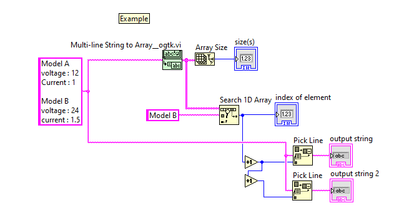

Hi Bob_Schor, thanks reply and sorry not attached the concept. Today i get some idea to try and the output similar what i want. Can u check my concept if have some concern or suggestion to find the great solution.. Thanks Bob.
-Labview 2014
-Openg Library

Please help me to help you.  You sent me a picture of your code, instead of the code, itself (the LabVIEW VI, a file with the extension ".vi").  That's like sending me a screen shot of a 5-page Matlab printout instead of the .m file!
Attach your code!  Please!

Sorry about that Bob. Here attached the program(vi file)

Hi Sr,
thanks for attaching the VI:
Pure LabVIEW, not even OpenG needed…

Hi GerdW,
wow that great solution. Thanks for your help. Thanks All.
