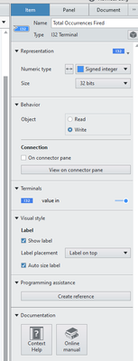

In the example "Occurrences", I see a terminal (named "Total Occurrences Fired") with "behavior" having options "read/write", instead of "control/indicator".
My question is how to generate/use this kind of variable in our programs.

Hmm... It looks like you are using LabVIEW NXG...
You might want to consider this post: Our Commitment to LabVIEW as we Expand our Software Portfolio before you put a lot of time into NXG.
