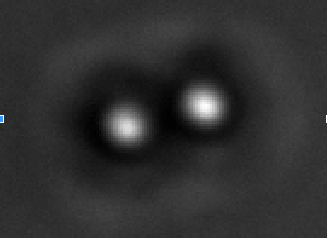

Untitled.png  My image looks like this.

All I want to do is to find the centroids of the two bright spots.

They look pretty symmetric and even seem to have about the same amplitude and width. Is that a valid assumption?
The background seems curved and dips below the average plane around the peaks. You might need a more complicated model, though.
Start with this and simply add a second 2D gaussian. For the starting estimate of the xy positions, I would initially use manual cursors
