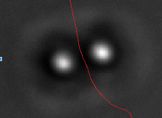

Fit Double Gaussian to a 2D array
Yes, my image looks like the one you have.  It's elliptical and with an angle.  I attached your code only because I changed some wiring when I use your fitwithRotation code  based on your 2DGaussianFit with offset.  I was just wondering if I was doing something stupid by mixing your two different codes.  I attached what I'm using with minor 'messing up' modification from your code.  Also in the fitting model, I added an offset too.  Thank you very much for your help.
