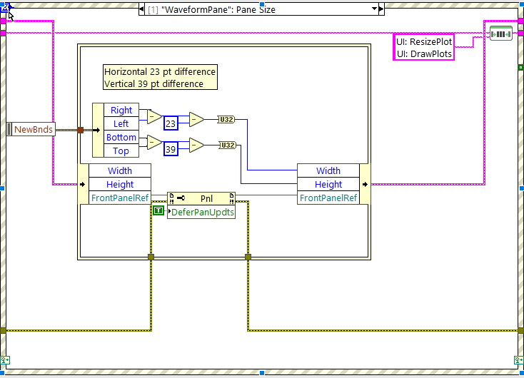

New controls show the same weirdness. I remember once to get around this problem, rather than use the scale, I calculated the size the size of the object I wanted to scale based on the pane size. I just used the size border I wanted with respect to the pane size. (See below) This worked, but it would have been nice if native LabVIEW scale to pane just worked. Note that you may want to reset the origin of the control also, as when you do resize it tends to move from its original spot.
