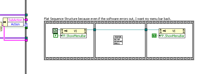

Speak of the devil.  I just opened a co-workers project and found one of those valid uses:
LabVIEW Pro Dev & Measurement Studio Pro (VS Pro) 2019
