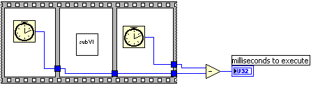

Well, well, for it was me who stated the lost commandment, i should perharps say something to it:
Since we are all humans (presumable i hope!), we are all sinners! 😉
Therefore, sequence structures are used. And i think every developer has encountered situations where he/she went for sequence structures.
But there is an imho quite good rule for the use of sequences:
Limit each instance of the structure "Sequence" to a single frame! Keep, if neccessary, multiple frames in order by dataflow-programming!
This is true for taking benchmarks or initializing resources.
Norbert
