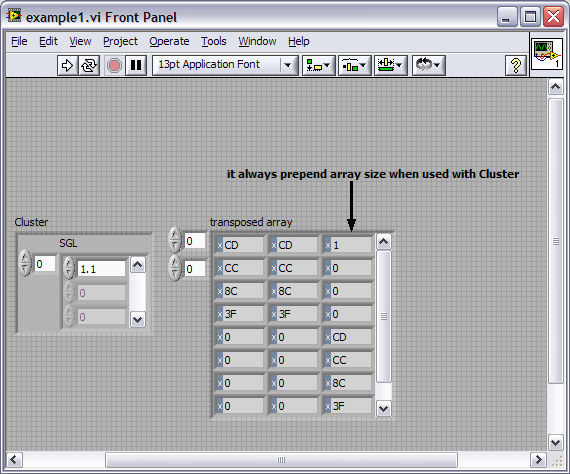

Why does Flatten To String Function always prepend array size when used with Cluster?
Is it normal?

If by "normal" you mean documented then yes.  I believe the same is true for arrays of strings.  Outside of a cluster, you can infer the array size from the length of the string (in theory).  Once you add the cluster, all bets are off so you need the length information to recover the data.

Thanks for your reply Darin.K
I thought the same thing that it would need size for Unflatten From String Function if it used in cluster. Because there could be more than one array.
Just want to make sure if there is an override.
