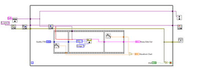

I am doing some benchmarking trying to find a more efficient way to convert a IMAQ reference to JPEG in memory and have noticed that how I wire the IMAQ reference makes a significant difference in the execution time.
With it connected as shown below it takes about 35ms to execute the flatten image to string function.
If I connect it via the annotated route (Through the first frame of the case structure) it takes about 5ms to run

Hi Worle,
@Worle wrote:
Why does that the minor wiring change shown above make a 7x difference in execution speed
Because you change the measured code sequence NOTICEABLE!
  1. When you wire the IMAQ reference to the first frame then you measure only the time needed for the FlattenToString function.
  2. When you wire the IMAQ reference to the 2nd frame then the first frame is already executed in parallel to the IMAQRead function! So you measure the time needed for the IMAQRead and the FlattenToString function…
All this is clearly defined by THINK DATAFLOW!
Conclusion: the FlattenToString will need about 5ms, the IMAQRead will need about 30ms (~60 30Hz frame rate)…

Of course....
I am going to blame that on a slow ramp up after christmas...
