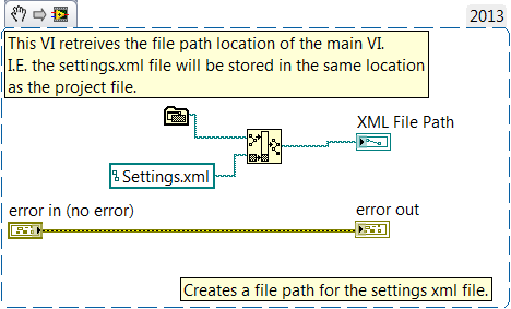

The file path is good as it does not change depending on the method used to save (Code to get the filepath is below). As for the output I'm not sure exactly what your asking for, just a copy of the XML document after the error? Unfortunately I don't have a copy handy.  On the plus side I found a work around though why it works is beyond me.  Before when the code saved the settings to XML directly after the calibration routine calculated the values it caused the error, but I I allow the program to run a few loop iterations with the new values in the settings type definition it saves with no error.  So now the program just loads the new values to the settings type definition and then waits for the user to hit a save button (thats there already for when they make manual changes) and it works.    I can't wrap my head around WHY it works as it seems to be saving the exact same information but there you go.
(3,475 Views)
Hi!
If the error is being generated by the Write to XML file.vi, I just wanted to check the velues of the two provided parameters
1) The path (..that seems to be ok)
2) The XML string generated by the Flatten to XML.vi. (This was the string I was asking for 🙂
Try to grab the value of the string when you have an error and check if there's something strange (I suspect you already this, though)
Is it possible that the file is being opened at the same time by another process/program?
