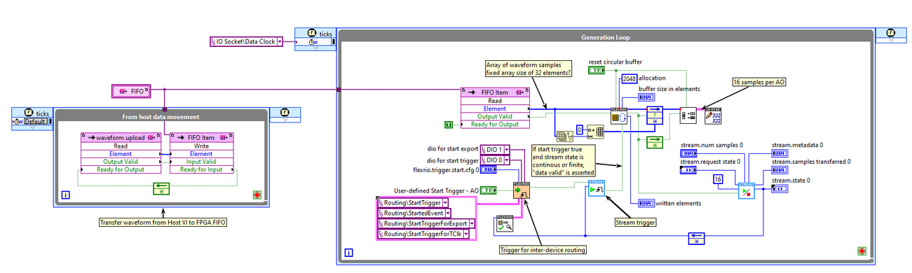

Hi I am starting to use a PXIe-5745 AWG and am trying to get familiar with the FlexRIO API.  I am going through the example program and have attached a screenshot of the Host VI below.  On the left there is a FlexRIO VI called "Configure Immediate Start Trigger".  What does it mean when it "triggers" itself in this context?  I don't think this is the point when it triggers to send a waveform.
Also, on the right there is a VI called "Start Continuous Stream".  What is a "stream" in this context?  Also, there is an input called "output stream instance" which is set to 0. I don't understand how this references the stream that is used in the FPGA VI (screenshot below) since none of the Stream VIs in the FPGA VI point to the same reference.

Hello, you may have referred FlexRIO Help installed with the driver, but let me attach it as picture below.
When start trigger is configured to immediate, "conditioned start trigger" output seems to stay TRUE, as far as I can tell from the example code.  Then, start stream makes Streaming IDL to continuously retrieves samples from the circular buffer.
As for Streaming instance.  Please refer to the below topics.
