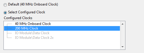

I think the NI 7972 should have 40MHZ, 100MHZ, and 200MHZ top level clock for choice, but I can only see 40MHZ and 200 MHZ on the menu.
11.PNG\
How can I let the system show 100MHZ?

Right-click the FPGA target in the project and add a New > FPGA Base Clock. Once you add the 100MHz clock here you should be able to select that clock as the top level clock of the FPGA.
