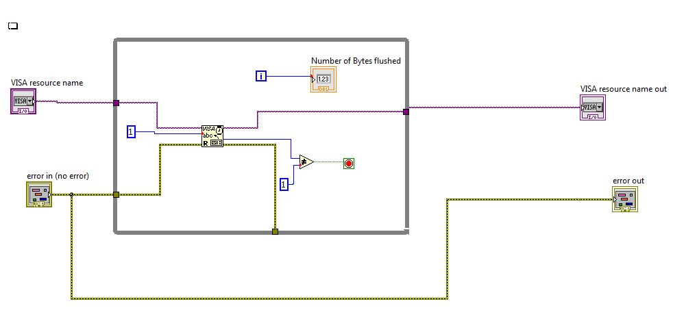

Regardless of the serial protocol on the device, if we do not read the byte until a read timeout to flush the USB RX right after opening the device. (with the little screen shot I attached up here) everything works fine.
Looks like the read on an empty USB RX buffer renders the USB read dead. Once we've had a timeout on a USB read, do we need to do anything to be able to read something again? Looks like closing and re-opening the USB gets it back on its feet... once.
