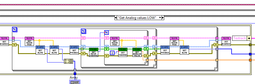

Today I ran into a stange LabVIEW probem. An "Last Value" output tunnel of a for loop returned the default values instead of the actual Last value. The code is below:
2014-03-18 15_24_53-Testrack Actor.lvlib_Electronics Check Sequence.lvclass_Execute.vi Block Diagram.png

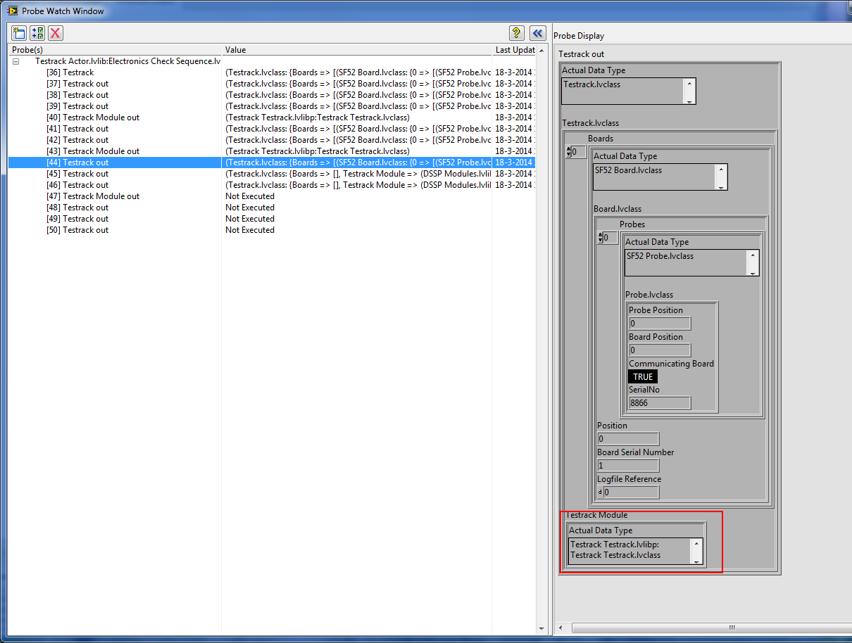

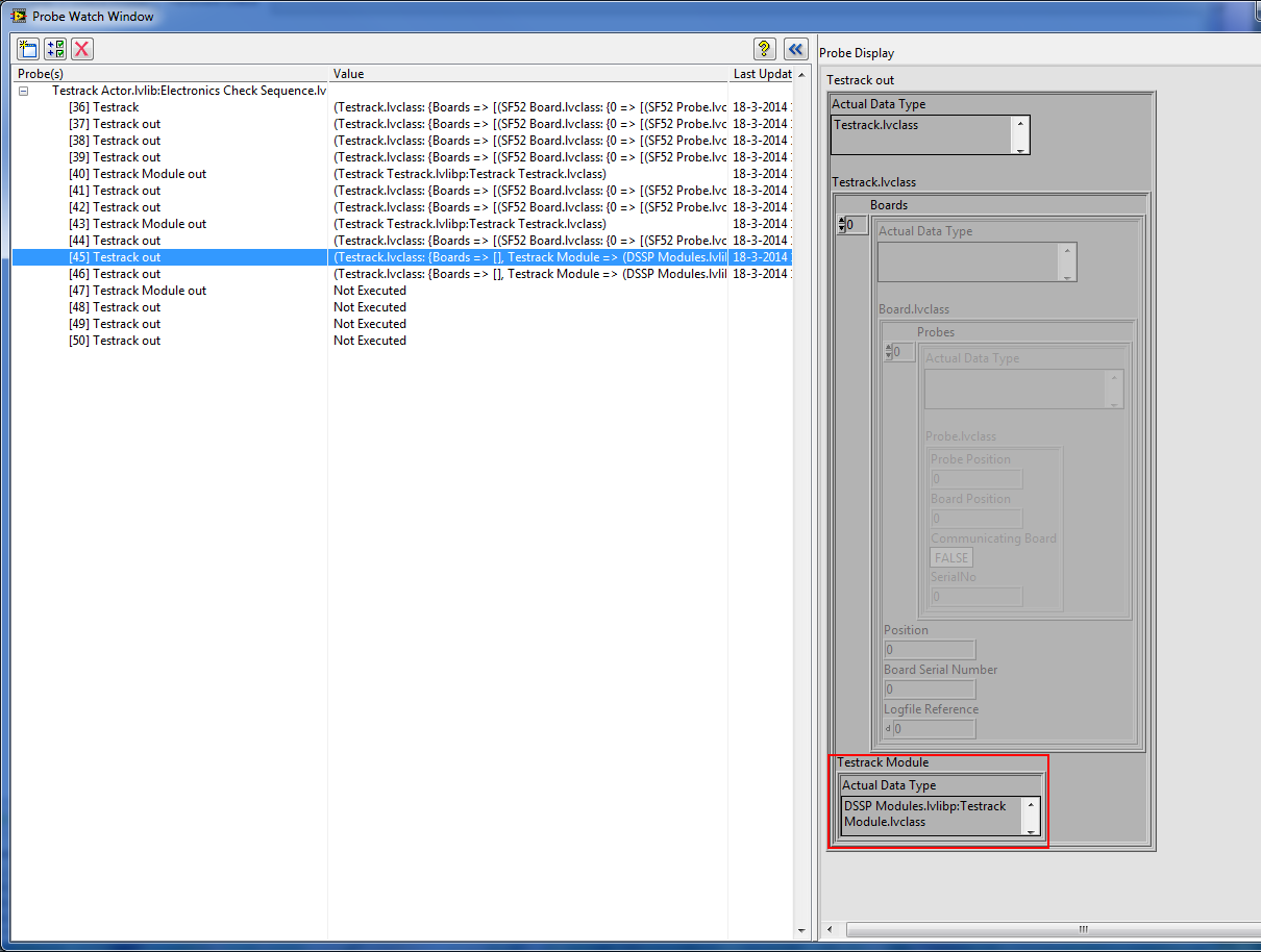

Below as well screenshots of the probes 44 and 45.
Where probe 44 contains al the data (all the boards are present (and the correct "Testrack Module" is used)) probe 45 is empty.

my first assumption: the for loop never executes as you pass an empty array to an auto-indexing input.
Another option, which is hard to see in the screenshot: Are there two input tunnels above the probe nr 42?
Norbert

Hi Norbert,
I think you found the problem. The 1st time I run the inner loop I have a number for the N input. (probe 90) however the other times I run the outer loop (auto index @ probe 91) this the value at probe 90 is 0. Smiley Embarassed
2014-03-18 16_09_01-Testrack Actor.lvlib_Electronics Check Sequence.lvclass_Execute.vi Block Diagram.png
However now I'm wondering how I can make a for loop that runs 0 times has wires running trough it (looks nicer) and returns the initial value (so probe 80 = 84). I mean, if I was doing this in C++ this would be the result. So some code how I would do this in C++ and the testrack would be unaffected.
