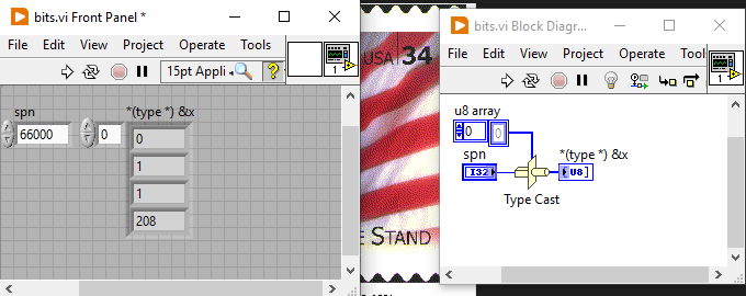

I don't know why you need a loop that doesn't do anything but count up, but you can type cast a I32 to an array of 4 U8's to get the described behavior.

I agree with @StevenD that the "solution" to your problem is to realize that your For Loop, which uses an I32 as the "N" value for the Loop Count, directs the "Index" (called "i" inside the Loop) to take on values from 0 to N-1.  Once you realize the (four) bytes of "i" are the values you want, you don't need to do any "arithmetic" on "i", you just need to break it apart into the three (or four) 8-bit U8 values (from 0 to 255) that comprise the number.  The TypeCast function will do this for you, but you need to make sure to understand the order of the Bytes in the Byte Array (is Array[0] the most or least significant bits?  not sure?  Write a little test code and let LabVIEW show you.]

If you use the Typecast, the byte stream order is in LabVIEW always Big Endian, or Most significant Byte first, or what is also called network byte order as many well defined binary network protocols use it. It was what the CPU on the first Macs used and there are nowadays no mainstream computer systems that still use this. The big dominating CPU architecture from Intel only uses the opposite Little Endian architecture and while ARM could do both it usually is used in Little Endian mode too. Other past LabVIEW platforms that used Big Endian natively besides the Motorola MC68020 in the first Macs  were the PowerPC Macs and PowerPC VxWorks cRIOs, the Solaris for Sun Sparc, and the HP Unix for PA Risc versions. All of them are gone and history since many moons, although PowerPCs are still working in many old embedded devices like printers and network appliances, but they were not programmed in LabVIEW.
You can also use Split Number in this case. It is a bit more obvious what it does.
