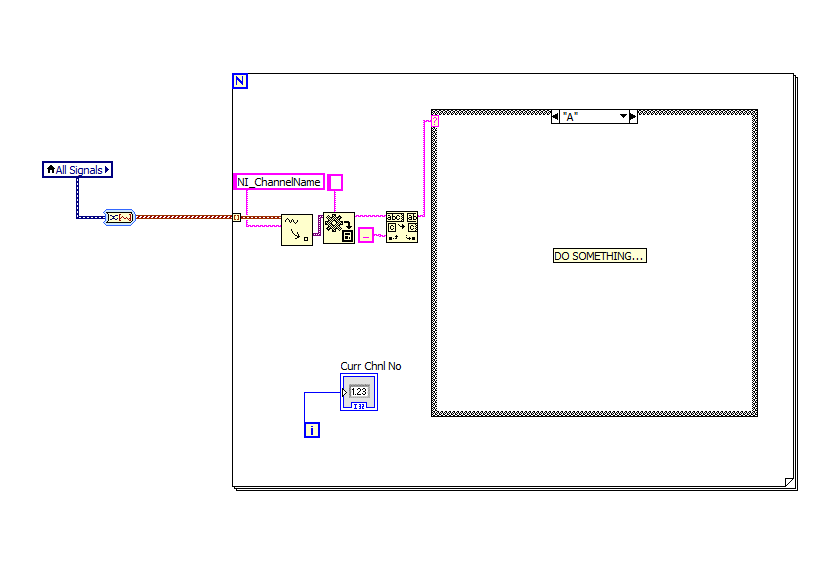

I have a tough problem that I hope LabView would allow me to solve easily:
I have an n-channel data acquisition stage where each of the channels could be one of the several possible types of signals. Let's say we have two types of signals - A and B - and that we have 8 channels each of which could be of type A or B as configurable by user. I want a FOR loop looping over all the signals and depending on their name (A or B) going into a case structure and doing stuff, like this:Capture.PNG
Now, imagine that "DO SOMETHING" is a subVI - "vi_A" for type A and "vi_B" for type B and that it needs to filter the signal.
Here I have a problem: the LabView cannot know that (for example) signal 1 being of type A and signal 6 being of the same type A are actually two different signals and the same instance of "vi_A" with the same instance of filter will be called. I need to be able to tell LabView to allocate a different instance of "vi_A" for different channel numbers above!
Is there a way of achieving this?  Could I, for example, preallocate 8 instances of "vi_A" and "vi_B" and use those preallocated instances by reference or something like that?
Thanks a lot in advance!

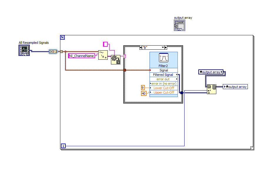

Here you go:
And attached.
I want the "output array" to contain 8 (or however many channels I have) distinct signals. As I understand it, currently the filter will be mixing/confusing all the signals of type A and all the signals of type B.
Thanks in advance!
Message 5 of 14
(5,039 Views)
OK, I have to assume here that your input contains N separate waveforms, each with its own ChannelName and type (attribute) A or B?
Just move your output outside of the for loop, make sure indexing is on, and you'll have N separate filtered waveforms, without having to clone anything.
Cameron
Correct on your first assumption.
But I am pretty sure you are incorrect stating that I will have N separate filtered waveforms, even if I move my filter outside. Filter has a buffer, and in my tests (on a larger and more complicated VI) LabView will create only 2 instances of the filter and each time you call case A it will be the same filter it used for case A last time. So, yes, I will get 8 waveforms, but they will be junk, because the filter mixes pieces of different channels of the same type.
Now, if instead of the filter I had a subVI that is preallocated clone-reentrant, then you'd see that each time a case "A" is called the same clone is opened and each time case "B" is called a separate clone - but the same for all "B" cases - is opened. This is the problem I am talking about. Filter is just an example - I need the clones to be distinct for each channel, not for each type of channel.

You cannot do this as easily as you'd like. The solutions that come to mind are:
1) Pull apart the filter (or whatever) VI so that you can pass in the state, then save that state in a shift register.
2) Actually allocate a new copy of the filter VI and call it dynamically, using Open VI Reference.
Neither of these approaches will work with the Filter Express VI that you show in your image; they'll both require digging into more LabVIEW programming.
It would be better to use a shift register around the for loop, instead of a local variable. It's likely that you don't even need the replace array subset at all, and you could just use auto-indexing on the border of the for loop (wire the output of the case structure directly to the for loop border) and then put the indicator outside the loop.
