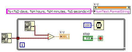

Hi Anders,
you got a problem, Years and months are a non-defined lenght of time.
This should work for getting the duration in days, hours , minutes and seconds.
Ton

okay, apparently the format into string solved the offset problem, but there is apparently an internal limitation in LabView with the realtive time so you cannot view years and month since start, so I guess I will have to settle with days. But it all works now! Thnx all! Also I rewired so I now have wires instead of nodes.
Attaching the VI I ended up with if anyone's interested. Suggestions are very welcome! (subVI's not of interest)
Anders
[Edit: Oh, TonP, didnt see your message before...would have saved me a lot of trouble finding out myself what you just explained, but thnx anyway!]

Eugen Graf wrote:
Try this one.
Message Edited by Eugen Graf on 01-16-2008 10:01 AM
THANX man, you save my day with the %<%H:%M:%S>t idea!
