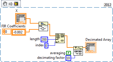

In the output will I see X[0] to X[N] or will the filter discard them for me. The decimation tool does keep the first value. So if my filter has 200 coefficents and I am decimating by 10. Then do I need filter then remove the first 200 samples out of the filter then use Decimate (single shot) VI to decimate by 10?

It looks like you are specifying a lowpass filter with near unity gain at 40 Hz and very low sideband at 1960 Hz.  In LV you will have to specify a cutoff frequency instead, probably in the 800-900 Hz range.  For a window you probably want one tweaked for low sidebands, I think there is one called low sidelobe or something like that in the LV vi.  You should be able to match the coefficients pretty closely if you choose a lowpass filter with 165 taps, cutoff ~800 Hz, Sampling Freq = 30000 Hz, scaling, and the low sidelobe window (or similar).  If I get to LV I will check it out.
When you apply the filter you get out the same number of points you put in.  The finite response time comes with the territory for FIR filters, if you are breaking up a large time series into chunks, just be sure to only initialize during the first call to the function.  The =0 comparison on a loop iteration terminal is very handy here.  If it is one big series then you may want to chuck out the first N points.
