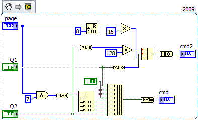

Hi Snehal,
two possible solutions:
(3,283 Views)

Hi GerdW,
Both the solutions worked.
Thanks for the help

Hi Snehal,
this task is just a simple building of an boolean array. You can go the long way and really build a boolean array or you go the shorter way of manipulating integers numbers as shown above.
All you need is some basic understanding of binary math… 😉
