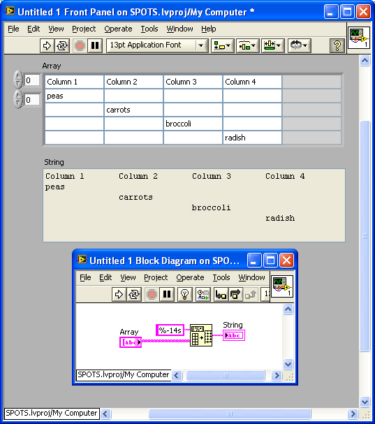

You can specify a length with the format string
So, if the longest string is 14 characters, specify %14s as the format string. Your text will be right justified. If you want the text to appear at the left, use a format specifier of %-14s.
Don't play around with multiple TABs, it will make the file difficult to read in other apps like Excel.
