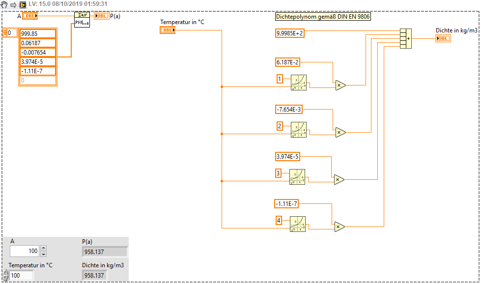

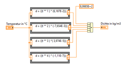

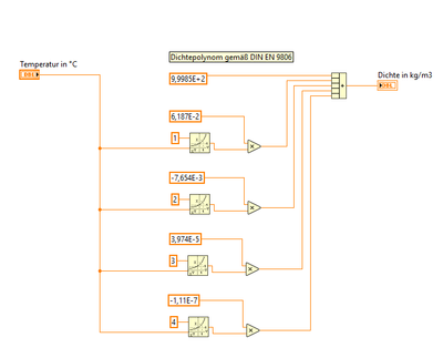

I don't see what is wrong in the equation I have entered. It is returning wrong output compared to my manual calculation. OriginalOriginal
Formula NodeFormula Node
Output (Original)Output (Original)
Output (Formula Node)Output (Formula Node)
Have I entered the formula wrong in the formula node or is there anything else I am doing wrong here?

I see the problem.
You are using a comma as a decimal point inside the formula node.  Don't!  Use the proper decimal point of a period.
Read the context help for the formula node.  It says, "
  • Formula Nodes accept only the period (.) as a decimal separator. The nodes do not recognize localized decimal separators."
