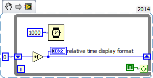

This is all you need:

You didn't implement any of the shift registers on the while loop.
