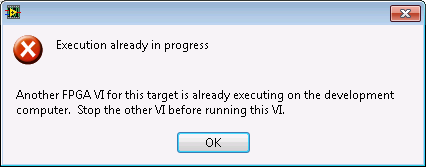

When running the "inverter.vi" (FPGA target but for now simulate on host) I get this error message dialog:
Execution already in progress
Another FPGA VI for this target is already executing on the development computer. Stop the other VI before running this vi.

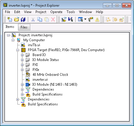

I can't see where I could stop this other fpga vi. In fact I can't find this other vi at all. Here is the project, which can't be any simpler:

Can you show us what the host vi looks like?  Are you opening multiple references to the same FPGA vi?
Are you closing the refecence when you end the vi?
Can you try closing down labview completely, then open a flexrio example from the example finder and try to execute on dev computer?

thanks for your quick reply.

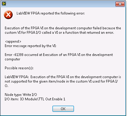

I tried restart LV and sure enough this changed things. Now I get this error

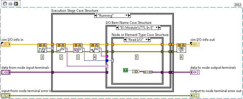

which could make sense as the IO simulation VI (simTb.vi in my project) is not tested (can't do that without the fpga target under test). This is shown in part below. Note that it is the auto generated template from fpga simulation setup dialog.

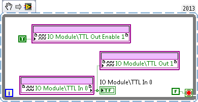

and here is the fancy fpga target vi under test (yes i try to make life easy:-))
So no host vi for communication with fpga - just the simualtion test bench.
Ok, I will work on from here and try to fix the error reported. Although I dont se any reason why it reports that its not supported to write to "IO Module\TTL Out Enable 1"
But clearly a restart made a diffence.

The error message (-61399 above) is telling that the "IO Module\TTL Out Enable1" is not handled in the Simulated IO test bench
It is important that all IO's are dealt with in the "Simulated IO test bench". This make sense at least for FPGA inputs which need to be driven to some state.
For FPGA outputs it is not obvious why a handler for the port is required in the test bench. Any comments on that?
(4,617 Views)
You are correct in thinking that simulated outputs shouldn't need a handler for the port, however, having a handler for outputs makes the switching between simulated and real hardware execution more seamless. It becomes cumbersome for developers to switch between simulation and using real hardware when there are major software differences between both modes.
