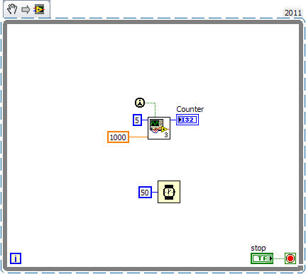

I made this counter, that counts from value x to value y.
This value I need in an other VI, so I made from this VI a subVI.
The counter value is needed in an other For loop to count with.
But the counter doesn't update his self every time, in that main VI.
How can I make the value frequently updated in that main VI without using a while loop.
If I put the global variable in a while loop it will update, but than the while loop will be executed constantly,
and the For loop won't be executed until the while loop is stopped.

If this is the main VI, than the value of x+1 doesn't update himself.
Inside the subVI the counter is counting, but the global variable and the "x+1" indicator don't show the counting,
only if I put them in a while loop. But I can't use a while loop it blocks other loops to run.

Hi Stef,
"Inside the subVI the counter is counting, but the global variable and the "x+1" indicator don't show the counting, only if I put them in a while loop."
If that's your problem: you have to obey the DATAFLOW paradigm. When you check the global only once, you will see no further updates. When you check the global frequently (in a loop) you will see updates.
"But I can't use a while loop it blocks other loops to run."
Why can't you? You should be able to use parallel running loops...
Hint:
- Go through the basics course offered by NI.
- Learn to think in DATAFLOW terms!

Reading/Writing with a global requires a loop in your top level VI. Using a reference and passing it to she subVI where you write to it's Value property does not.

Ofcourse they dont show anything. You have a loop in a sub vi, and the result you get out is the end result once it stops executing. That's basic dataflow.
Your counter2 reads the global variable once and shows the result, it doesn't automagically follow and update from the global variable. That's basic dataflow.
Your program does exactly what you told it to do. That it makes little sense is not basic dataflow. 🙂
Run the program in highlight mode and it should be quite obvious. But main and sub-vi.
